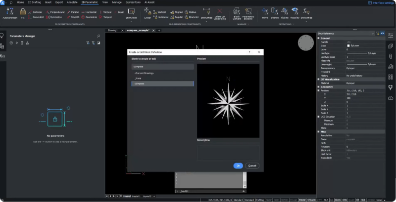

Double Click BEDIT mode
  • To enter BEDIT mode, double-click an instance of the block and click "OK."

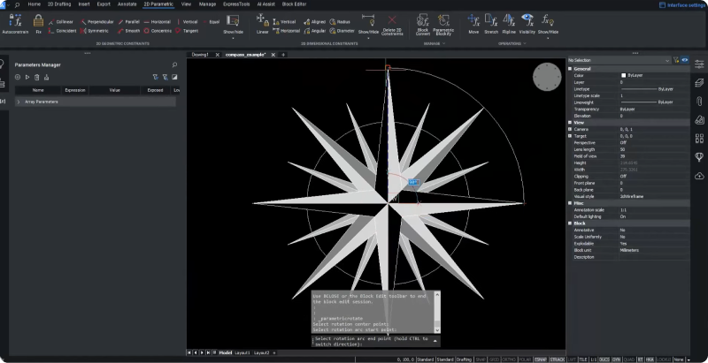

  • Navigate to the 2D Parametric Ribbon panel, locate the Operations sub-panel, and click on it to open the drop-down menu.
  • From the drop-down menu, choose "Rotate."
  • Or, enter the PARAMETRICROTATE command.

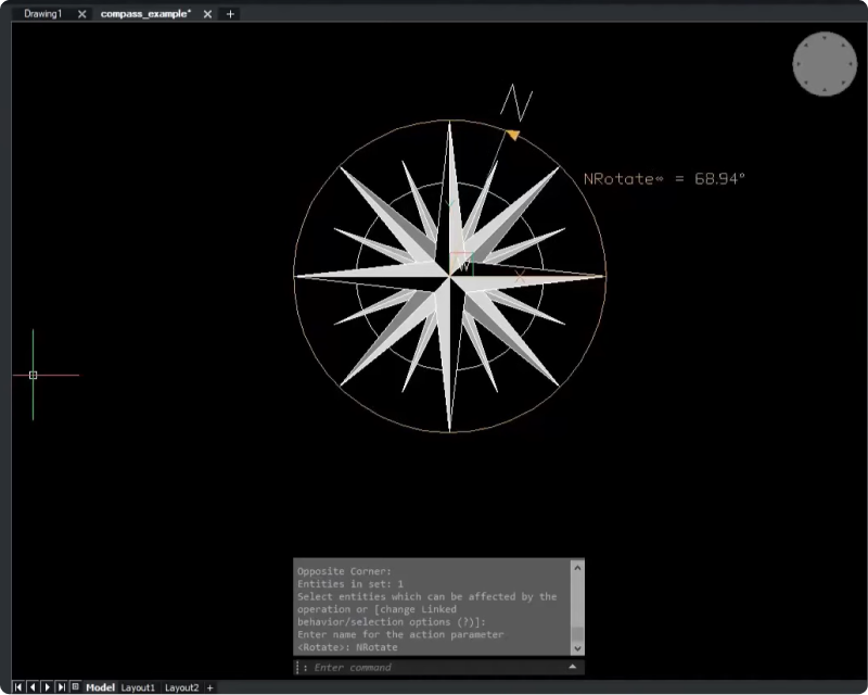

3 points rotation arc
  • Then, choose three points on the compass to define the initial rotation arc.
NRotate
  • Select the N symbol entity to rotate it, and choose a name for the new operation - we named this one "NRotate."

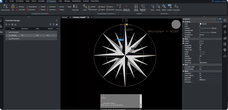

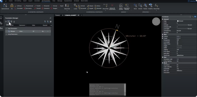

Once you have created an operation, you can inspect it to validate its behaviour. One way you can do this is with the "Animate" button.
  • Click the "Play" button in the Parameters Manager to begin the animation.
After selecting the "NRotate" parameter you just created, click the "Animate" button to see that the N symbol now rotates. However, the compass geometry stays in place, as we didn't select for the compass geometry to change too. But we can fix this in just a few clicks!

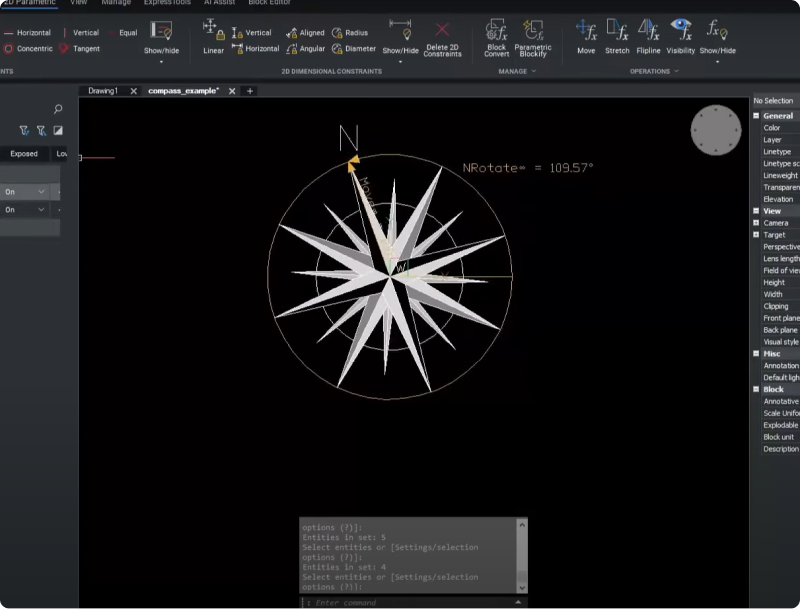

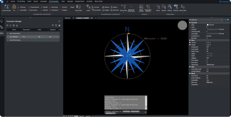

Edit parameter
  • Right-click the "NRotate" parameter in the Parameters Manager panel and choose "Edit selection."
Compass geometric entities
  • Then, select the geometric entities of the compass.
compass animation
When you click "Animate," you can see that the rotation operation you applied to the compass works as expected.

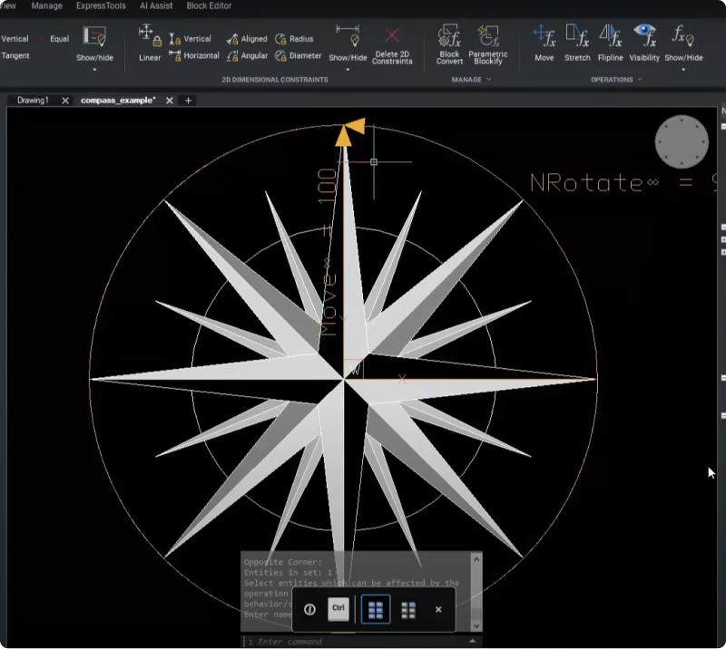

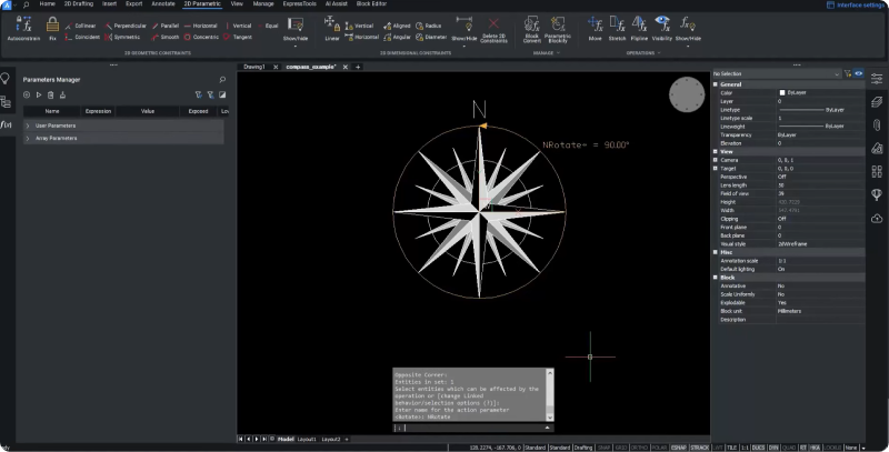

We also want the N symbol on the compass to stay along the arc while maintaining a horizontal position. In BricsCAD V24, you can do this with a new feature that allows you to combine linked parametric operations and apply them to a block.

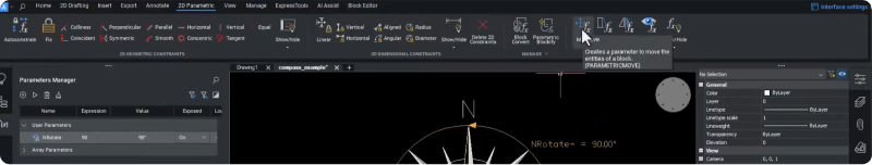

Move
  • Create a new "Move" operation by navigating to the 2D Parametric Ribbon panel and clicking "Move."
Move Vector 2 points (1)
  • Then, pick two points of the "Move" vector and choose the N symbol as the entity to move.

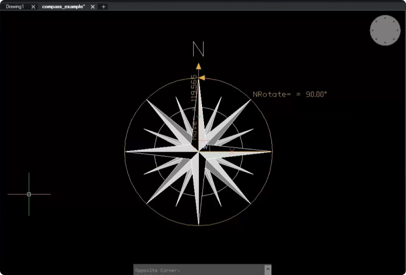

Animate N vector
  • Check how the operation works again using the "Animate" button, and you can see that the N symbol moves along the indicated vector.
Linked Operation
When you zoom in on the compass, you can see an infinity symbol beside the parameter name - MOVE- indicating that this operation is a linked operation.

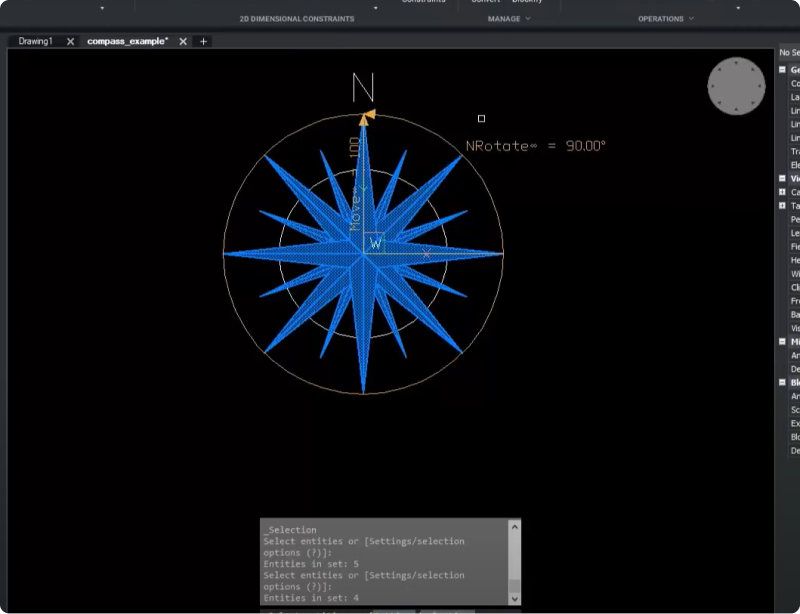

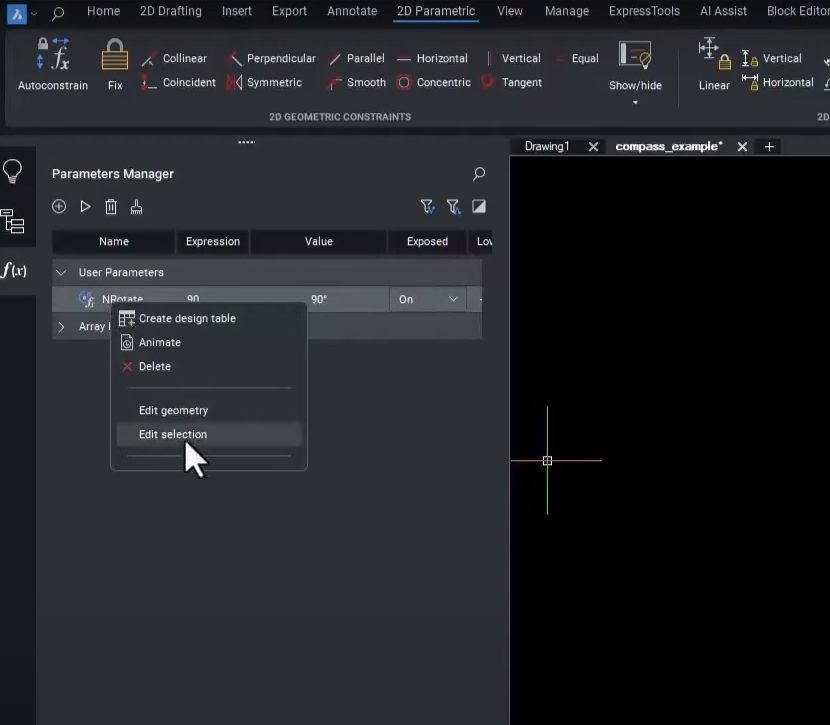

Now, we want to rotate the move vector without rotating the N symbol.
  • Right-click the "NRotate" parameter and choose "Edit selection."
Remove N selection
  • Add the move operation line and remove the N symbol from the selection.
Animate N
Once you animate the NRotate parameter again, you'll see that the N symbol moves along the arc without rotating. This is because the "Rotate" operation rotates the "Move" operation we linked it to, dragging the N symbol with it.

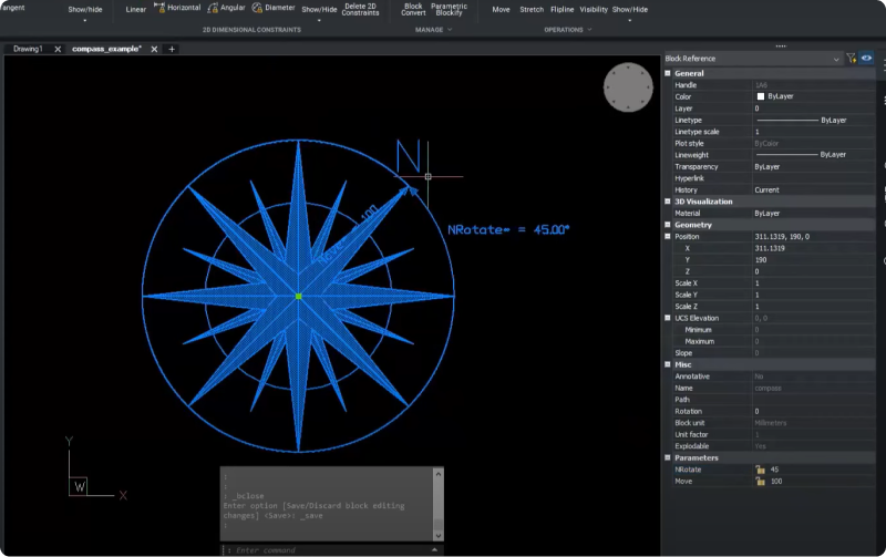

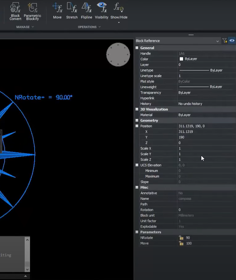

Customizing Block References in BricsCAD® V24
Block Reference Panel
  • Navigate to the Block Reference panel to check how a block user can customize a block reference. In the Block Reference panel, you can see the parameters for the block references "NRotate" and "Move."
N 45
  • Set the "NRotate" parameter to 45 to define the North point in the top-right direction, and you have successfully changed the block reference.
