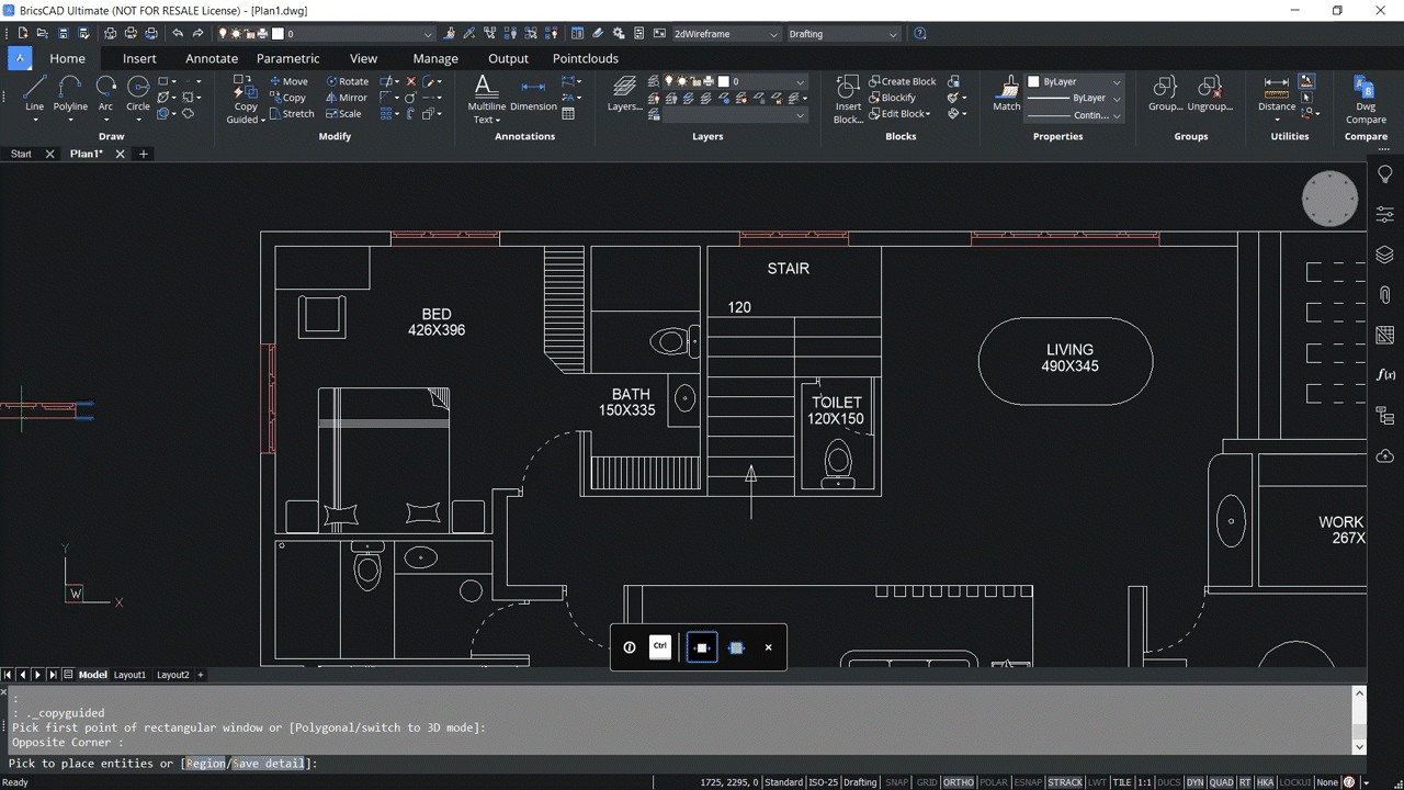

The next step is to select the entity you want to copy by clicking and dragging with the mouse, as you can see in the example below.
How to use CopyGuided and Moveguided commands in BricsCAD 0.40-0.44
You will also see in the example that the wall lines have turned blue after the window is selected. These blue lines will act as guide curves for the COPYGUIDED command. Using these guide curves, you can align this object at any desired location in your drawing.

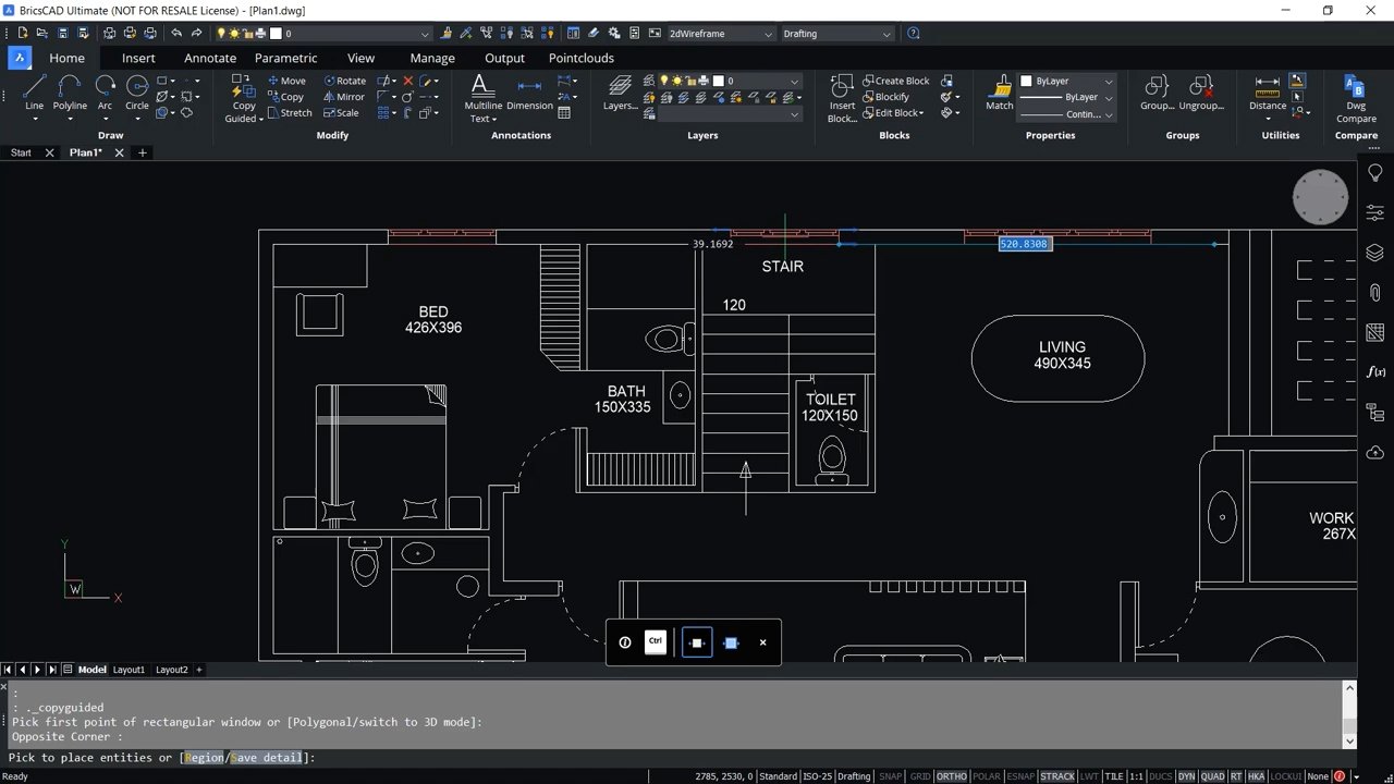

You can see how that works in the example below. When you select and drag the entity, the guide curves move along with the entity. You will see two arrows on both sides of the window below. The blue arrows indicate the anchor points and direction of the guide curves. The copied entity will only align with the geometry that matches the number of guide curves and the distance between them.
How to use CopyGuided and Moveguided commands in BricsCAD 0.59-1.03
You can see how this works in the example below. The window entity won’t align with any of the inside walls because the guide curves don’t match up. But when we drag it to one of the outside walls with the same geometry, it aligns with the wall perfectly.

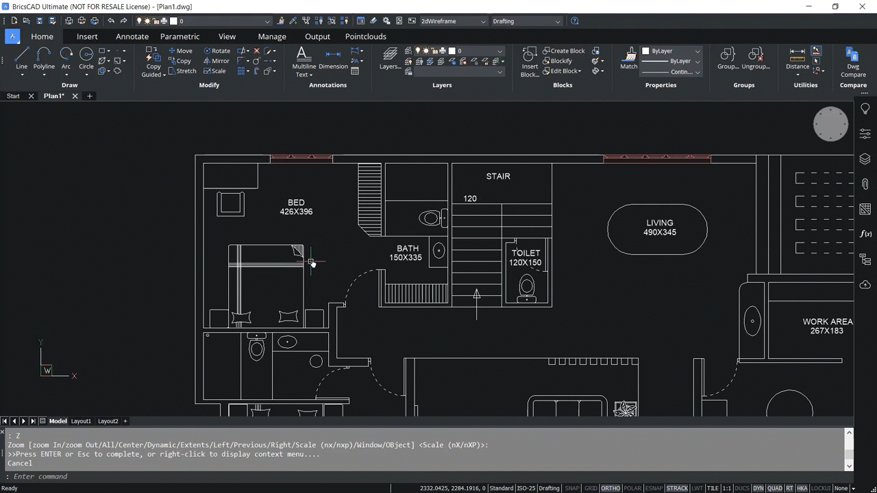

When you erase the entity, BricsCAD will automatically clean up the drawing, as seen below.
How to use CopyGuided and Moveguided commands in BricsCAD 2.26-2.30
All of this functionality makes the COPYGUIDED command a replacement for the 'Copy', 'Rotate', 'Mirror' and 'Trim' commands in this context.
